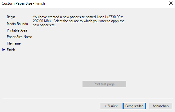

I want too plot a plan which is 297x2930mm. I was able to print the same file without issue on my old computer (AutoCAD 2022) but on the new computer it do not work :
If i click one of the two "use a custom paper size ..." I direclty come back to the plot window but with plotter : None and papersize : empty
if I try to add it mannully it do not find it after saving and i cannot print test page:

Thanks a lot for your anwser. I was still on AutoCAD 2022 and it was working. I just turned to AutoCAD 2024 and it doesn't work anymore.
I was using "DWG to PDF.pc3" but I also tryed "AutoCAD PDF" and some other. No one was working (always the same reaction).

I just found the solution to my problem. AutoCAD could not write the .pc3 file. The solution was to create a new .pc3 file and .pmp file in the temp ordner and to used them to print.
