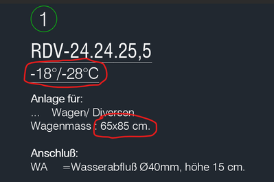

I am currenty making a block with 4 language types.
In these visibilitys the rack sizes are all the same, but the position varies because of the language.
I thought it was a smart solution to use fields to create a workaround so that when I change the Atribute, the racksize updates regardless of which visibility i use.
The problem is that the fields don't update when the attribute is changed. Even after to regen and check some settings it still doesn't update.
A solution or a better workaround are both welcome

s_hendrikxHMCCF
Thank you for your reply,
thanks for the tip of auditing the file, there were indeed some errors.
The struggle i have is not with the numbers that resemble the size of the cube.
I'm sure you'll have double clicked my block and saw that there were some adjustable attributes. Two of those are linked to the visible 65x85 cm meausurement and the temperature of the cell.
The problem is that the fieds linked to the attributes don't change.
The measurement behind "RDV" and in the titleblock should be functioning well.
Hope this explains a bit better.
