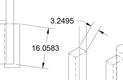

I have a 3d drawing from which I have created base views in paperspace. Now I want to snap at intersection points of lines in base views for the purpose of dimensioning but i don't see any method of doing it. please help me out because my drawing needs to be dimensioned at intersection points only

Is your Intersection object snap turned on?

Viewbase views that are orthogonal can be dimensioned by using Osnaps. Isometric views cannot be dimensioned in this manner. I workaround this limitation by creating construction lines in paperspace that are based upon the intersections/vertices and then dimension from them.

If you are trying to snap to an intersection of 3D lines that are at different elevations, you can use the "Apparent" Object Snap
