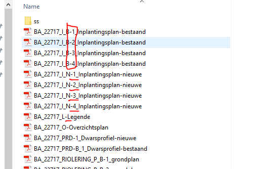

I want to print pdf file name as "file name _ layout name" instead of default naming format "file name-layout name"
File name: BA_22717_I_B
Layout name: 3_Inplantingsplan-bestaand
Require pdf file name format: BA_22717_I_B_3_Inplantingsplan-bestaand

Use a Windows file renamer free app to replace - with _ after the fact in the meantime.
I have problem to rename at time of submission with 100 to 300 drawings. I am looking for some sort/smart way to create pdf with project required naming format.

There is no Way inside Autocad (Except you want to type every Filname by Hand, then use another PDF-Driver).
With a good Softwaretool it is easy to rename 1-10.000 files.
Are your DWGnames have all the same length?
So you could rename char 13 from "-" to "_",
Or if all Layoutnames starts with a Number, search for "-#" and change "-" to "_"
I dont know all about your File an Layoutnames, so i csn not figure ouz the best way for you.
