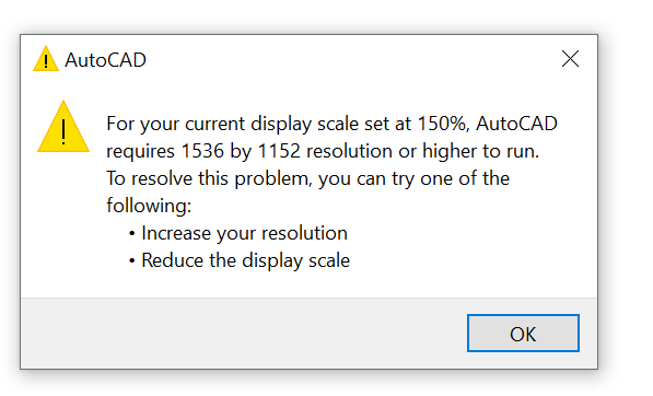

how can i remove the display scale message every launch

iam fine with these scales i don't want to see this annoying message with annoying sound everytime i open cad

The background information is that AutoCAD needs a minimum resolution to work well (and to be able to show ALL dialogs correctly).
When you have e.g. a resolution of 1280x1024 and your Windows DPI scaling is 150% then the resolution AutoCAD gets for dialogs is
1280/1.5 = 853
1024/1.5 = 682
Which results in a virtual screen resolution of 852x682 ... to less to present all dialogs correct inside the software.
As this would make a lot of users angry the warning message appears which gives you a valid description, raise the resolution or lower the Windows DPI setting so AutoCAD has a chance to work as expected.

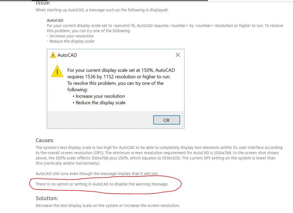

Message 11 of 14
didn't work
