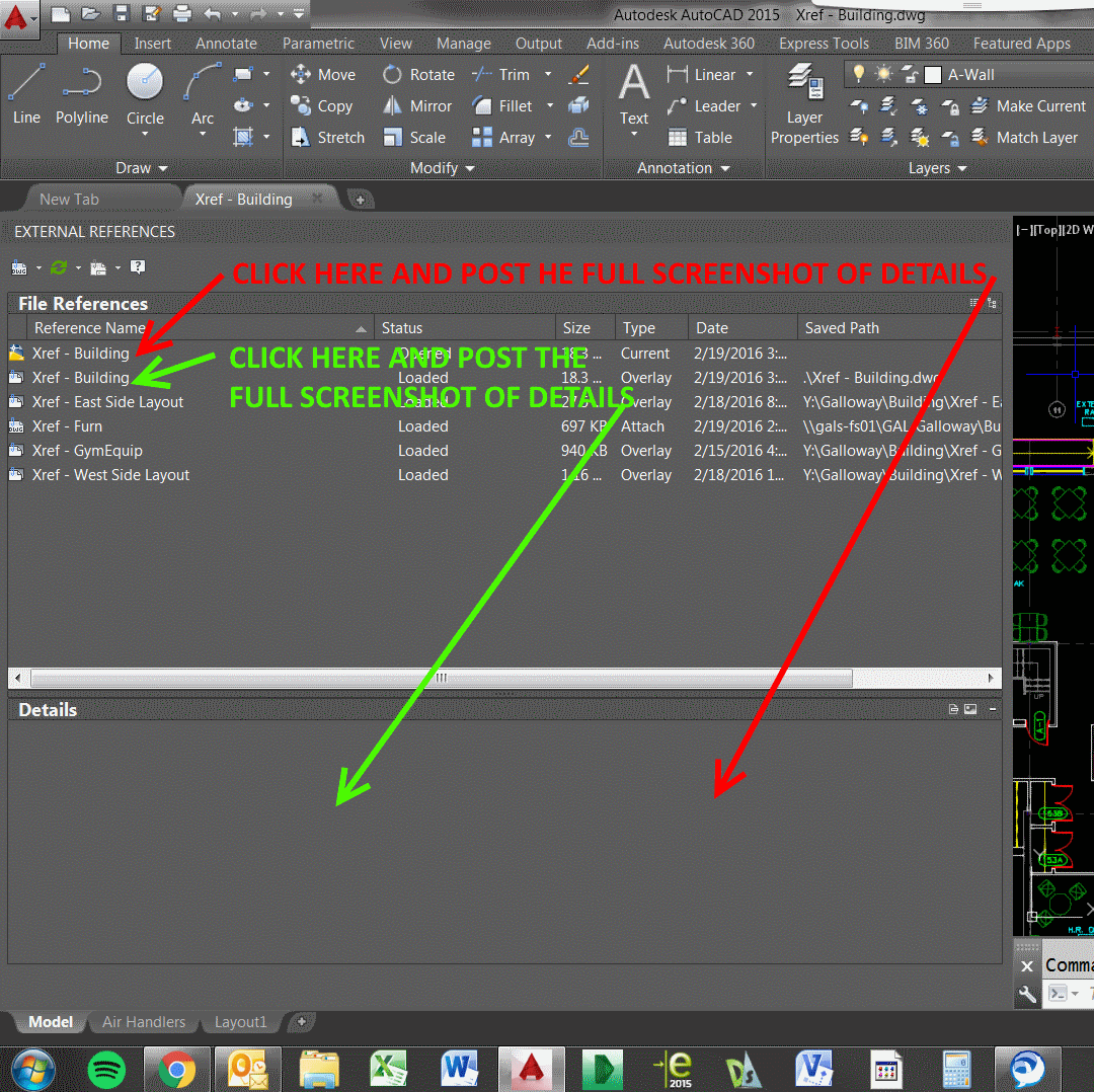

If you're not able to do any of that then I need a lot more info then, or you need to jsut live with it, as I am unable to XREF a file into itself no matter how hard I try: see below, each color ought to be it's own screenshot(s).

Autodesk seems to think it's possible I suppose - at least through a circular reference. I'd like to see the TREE VIEW of the External References palette too.

And everything else I wrote in my previous reply?
If you can't WBLOCK with Window selection to clear it as I noted, then a copy/paste will also most likely fail for the same reason. Unless you didn't do any of it.
Did another program create your DWG files?
