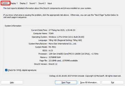

NGUYENVANTOAN_CXCKPT
Xin chào CGBenner
I send you the hardware information I am using
Thank you, have a
Thank you, have a nice day

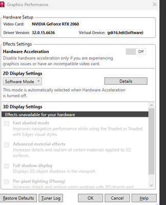

Hi  imadHabash
I turned off hardware acceleration. But it didn't fix the problem.

paullimapa
your computer's graphics card may just not be compatible with 2024 & 2025:
Solved: Can't enable hardware acceleration - Autodesk Community
Maybe try rolling back the graphics card driver or see if there's an updated driver to see if any of this would make a difference.
