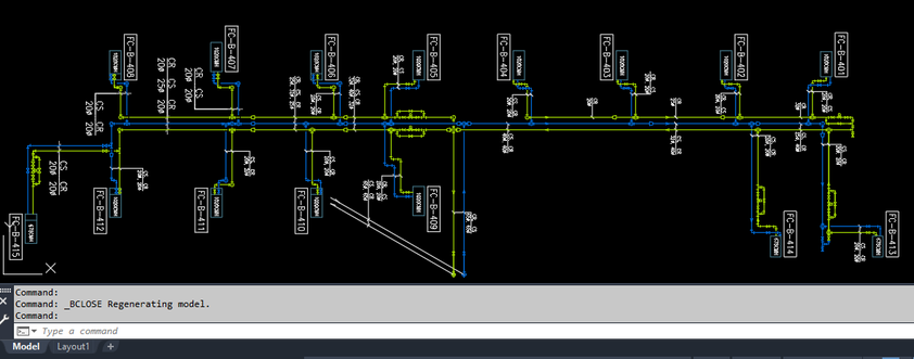

I was editing a block in AutoCAD 2024. When I finished my work and exited the block editor I couldn't see any other elements besides the block. I thought it was just a visual bug so I saved my file and restarted AutoCAD. The DWG now got stuck in block editor mode showing only the particular block. Elements in the block are now editable without entering block editor mode. Zoom to extent would only focus my window on the block instead of the entire drawing. Entering and exiting block editor mode by editing a nested block doesn't do anything. Elements outside the block are now part of a block with the same name in the Blocks palette, as if out of nowhere AutoCAD decided to take out everything inside the block and put in everything outside the block.

Hi, the drawing is supposed to look like "DWG Recovered.dwg". "DWG with Issue.dwg" is the file after the bizarre event and it only shows part of the entire drawing even if all layers are turned on and no elements are isolated.
I'm already out of the office so I can't check now but the particular block with issue should have words like "B Office" and "Pipe" in its name. If you try to insert the block in "DWG with Issue.dwg" you will notice whatever elements that are gone are now inside that particular block. My AutoCAD froze every time I try to edit the newly inserted block in "DWG with Issue.dwg" so I couldn't tell if it is possible to reverse whatever that happened. I ended up using a recovered DWG file instead after a few tries with no progress.

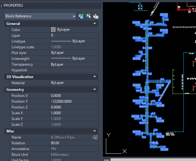

So you're telling us that the original dwg prior to the crash looks like this:
Then you performed a BEdit on B Office 4 Pipe which should be oriented vertically like this:
But after the crash you ended up with a dwg with the original Block Exploded and oriented Horizontally like this:
