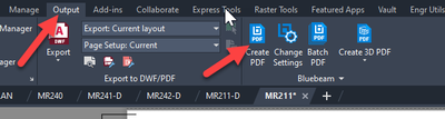

I didn't realize you are using the Bluebeam printer driver. Use the Bluebeam plugin on the Output tab and it won't add the (1). It only uses the file name and not the layout name.
