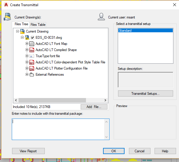

 John,
Please let me know what I need to change on the setting to address Jessica's concern on the files being sent. (see attached images)
Malou

Malou actually has left for vacation. What is happening is that when she sends me her files they come with the folder name added to the extension. ( see attached) She's not sending them that way but when I download them there it is. When it adds the name of her folder " current Dwg\ " the files wont open on my end.
I just downloaded CAD 2017 Lt for mac and its still doing it.

Under "Path Options" in the transmittal setup, she is using "Use organized folder structure" with a source root folder in drive 😧 (which is forced into the file structure in the etransmit package).
Do you have the same drive and root folder on your Mac? Maybe try changing the option to "Keep files and folders as is" and see if that doesn't help. That option uses a relative path for the files, so it shouldn't matter if there is a different root folder on your Mac.
