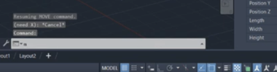

grenier4
>>"Why is Dynamic Input interfering with the ability to type @<enter> in the command line?"
It isn't (or it shouldn't). Record a screencast and show us your problem (please work slowly, so we can better following all details)
See this YouTube video showing my issue with Point Filters, Dynamic Input, and typing @<enter> to preserve the other values of the base point when moving objects. DYNMODE is set to 3.
Dynamic Input is interfering when I'm using a two-coordinate Point Filter (YZ). For some reason it's not interfering when I'm using a one-coordinate Point Filter (Y).

cadffm
Thank you for this video  - bad quality, really hard to see - but it was good enough.
It shows your steps and I can reproduce it, so it works as designed (not as expected, but as designd)
Okay, you don't followed my sample, you used another one!
What is the difference between what I said and you did: The Order!
I can't say why it not works in your case, but if you following my sample it works.
First: .X @
then choose your YZ Point (but you don't need to start .YZ filter now, just click to the point)
Just:
move/object selection
basepoint<click>
.X
<second point>
done.
