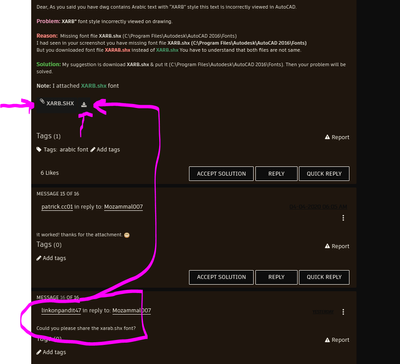

Dear, As you said you have dwg contains Arabic text with “XARB” style this text is incorrectly viewed in AutoCAD.
Problem: XARB” font style incorrectly viewed on drawing.
Reason:  Missing font file XARB.shx (C:\Program Files\Autodesk\AutoCAD 2016\Fonts)
I had seen in your screenshot you have missing font file XARB.shx (C:\Program Files\Autodesk\AutoCAD 2016\Fonts)
But you downloaded font file XARAB.shx instead of XARB.shx You have to understand that both files are not same.
Solution: My suggestion is download XARB.shx & put it (C:\Program Files\Autodesk\AutoCAD 2016\Fonts). Then your problem will be solved.
Note: I attached XARB.shx font
Tags (1)
Message 15 of 20
patrick.cc01
in reply to: Anonymous
it worked! thanks for the attachment. 😁

linkonpandit47
Could you please share the xarab.shx font?
