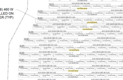

Really perplexed here. I have a file where I am using multiple instances of the same block with attributes, but when I print some of these attributes are displayed upside down.
I have tried a print directly from modelspace, I have tried printing the layout from a sheet that uses the problematic drawing as an x-ref, print preview in both circumstances shows the text in the correct orientation but when I generate the PDF the actual text occasionally is inverted.
I have checked the orientation of the blocks as well as any text settings both within the block editor and within the attribute definition dialog boxes. I have tried printing the file in AutoCAD 2021 as well as 2023. There is nothing that seems to be problematic, and while the inverted text appears somewhat random, the locations of the inverted text are consistent from plot to plot (ie, the same instances of the blocks are affected each time, even though there does not seem to be any differentiation between the affected blocks and the blocks around them).
Please note:
- this is happening on more than one block type in the same file, seemingly randomly. note that the inversion is happening on rows G-30, G-27, G-24, and G-23 with my 10-string blocks (all the blocks in rows G-22 to G-32 are identical), and also on row G-21 (rows G-12 through G-21 are my 6-string blocks).
- all settings for the blocks are identical, there is no perceivable difference between the affected blocks and non-affected blocks
- I have audited the files, and also purged the files to ensure any errors that might be causing the problem are corrected. Both Audit and Purge are showing no errors and no more elements to purge.
I am attaching a couple of image files as reference (these are from modelspace and print preview where the text is not inverted) as well as PDFs showing the print error from a modelspace plot (from the source file) and a paperspace x-ref'd plot (the actual planset plot minus the titleblock). If there is an easy fix without uploading the specific CAD that would be preferred as I need to redact or remove some information were I to upload the CAD file, but I can do this if need be. Anyone seen anything like this before? Any suggestions?

The attributes are not upside down, actually, they are mirrored.
I thought it might have something to do with the UCS rotation, but changing it seems to make no difference.
Which PDF output driver(s) have you used?

Digging down further into the problem on my end, Adobe PDF and Microsoft Print to PDF generate the attribute text with proper orientation, but these printers are clunky and take forever to print (and failed miserably printing the problematic file when linked as an x-ref)
the problem seems to reside with either the built in AutoCAD PDF printers (DWG to PDF or AUTOCAD PDF), or their interfacing with the attributes in these specific blocks.
See attached a new screenshot of the problem in a PDF file (inverted entries are highlighted), as well as the actual PDF with some inverted entries highlighted.
If I have left out anything that could be helpful, please ask and I am happy to provide it as quickly as possible! I much appreciate the assistance!

solphi.guthrie
 reposting the image snippet embedded in the forum post for clarity!

@dmfraziergreat observation and perhaps an important point, they are mirrored and not upside down.
the internal autocad PDF drivers (DWG to PDF, AUTOCAD PDF) seem to be problematic, or at least how they are interfacing with the attribute text in the block.
If I print with Adobe PDF or Microsoft Print to PDF the bug doesn't manifest, but those drivers are garbage and a) take forever and b) fail when I try to print a file with the problematic base file x-ref'd.

I don't know if this will help or not, but after using BEdit to change the attribute's style to "Standard" (which uses simplex.shx), running AttSync, and then plotting (one time) to PDF using AutoCAD PDF (High Quality Print).pc3, the mirroring did not occur.
(Was it the style change, or was it the AttSync? Hmmm.)
Message 12 of 15
dmfrazier
Changing this PDF Options setting for the aforementioned PC3 also resulted in a plot without mirrored attributes:

@dmfrazierThat looks like it does the trick! Are you aware of any repercussions for changing these plot settings? I was able to copy and paste the text in question out of the file, so I suppose it's still searchable and all.
I just spent the last hour and a half with AutoCAD tech support and they've flown this up the flagpole to the development team. I will keep everyone posted, I'm tempted to just accept the above solution but let's see if there's not a more robust explanation before I close this thread (for all of our sake).
