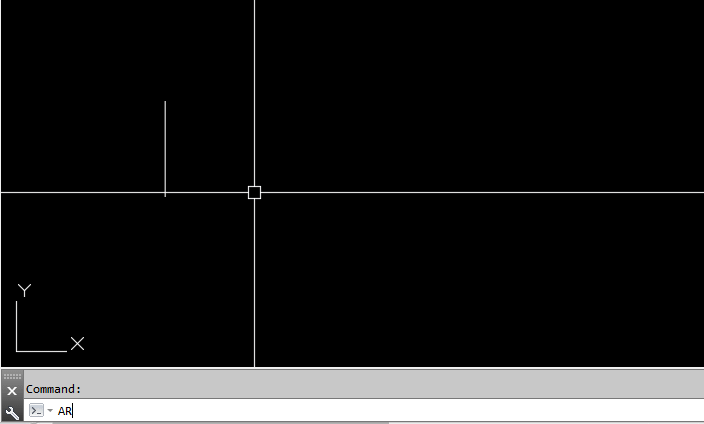

That is exactly right Edwin! Here is a animated gif for you.
A simple line in 2D my video card can handle that pretty good. ..but as you might know ...
doing more complex 3D modelling switching from 2d to '3D conceptual' styles and vice versa does hold up and consumes computer power!
So... Save the world ! Save Energy ! 😉 .. Save my time and don't switch when i don't tell you to..
capirsi2017-09-28_11-01-12.gif?

It is not a localized issue. I can reproduce it on AutoCAD 2018 English. You can see it in the screencast. The UCS changes when the command is active, showing that the Visual Style is no longer 2D wireframe.

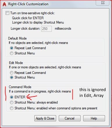

On other thing about the 'Edit mode' of an array.
Somehow my right mouse button is working not as it should.
It ignored the setting i work with
Feels like a bug, Hope Autodesk can fix this too with new release coming.
