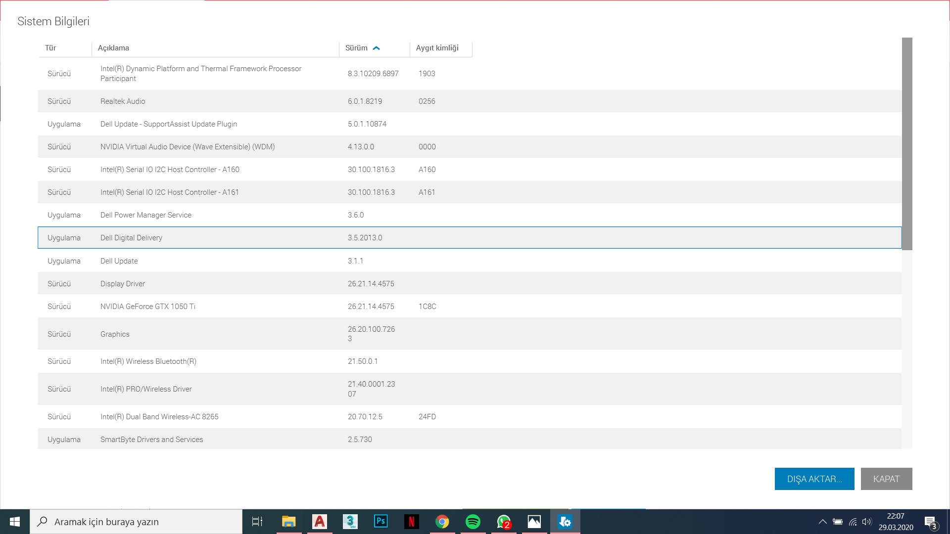

I didn't expect you to answer that fast. Thank you! I did what you said, I added screenshots below.

thank you for your screenshot ... you are both using driver version 26.21.14.4575
So I would recommend to install an older driver (and disable the automatic update for nVidia).

I have been having the exact same issue on my laptop and installing an older nvidia driver for GeForce GTX 1050 Ti worked. They actually came with a hotfix for version 445.75 of the driver; 445.78. This does NOT solve the problem. So I did a clean install of a driver from when I remebered autocad working properly, it was released on march 19 called version 442.74.
