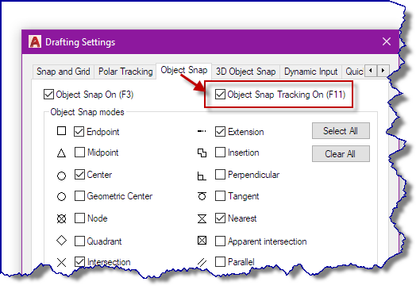

Alfred.NESWADBA
by any chance, do you have "Object Snap Tracking" (<F11>) active on your object snap settings?
If yes please disable it and try the object snap behavior again.
- alfred -

pproestos
Thx for the answer Alfred,
No, I have it already disabled.
Still I am having this problem...
