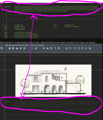

I have continually had this issue (specifically with AutoCAD LT 2022 and Newer) where often my text (Josefin Sans) don't read correctly, specifically the Regular font style, and reads as a 'wire-frame' (it's assigning a default text to the standard). This issue create formatting issues when the thickness is not correct.
Sometimes it works, reads correctly, but after a month or so if I restart my computer or CAD starts slowing and I close it, the issue often comes back and I restart my computer 10-15 times before the issue is resolved (if resolved). Per previous discussion with @maxim_k, he advised I download the font and only upload Regular, Italic, Bold, and Bold Italic into my font book, which I have done.
The issue seems lie within more recent version of AutoCAD LT for Macs as see the snapshots below taken at the same time. 2019 reads CORRECTLY and 2022 & 2023 read as a 'wire-frame' as if the font is not being picked up. NOTE: When I plot/publish, the graphics of the Josefin Sans Regular font are correct...however when setting up the files and sheets, the formatting is the issue when reading thinner than the actual.
Can anybody help me with lasting solution?
2019 AutoCAD LT on Mac Snapshot (This is how it should look)
2022 AutoCAD LT on Mac Snapshot (wire-frame...oddly the BOLD version reads correctly on this sheet, not shown)
2023 AutoCAD LT on Mac Snapshot (wire-frame...oddly the BOLD version reads correctly on this sheet, not shown)

Your screenshots to me look like you have a font substitution taking place, not much else
Can you confirm that in STYLE command? Or are these MTEXT with manual font overrides inside the editor?

maxim_k
Hi @helloWYGL9 ,
From your screenshots in the second post I see that Regular typeface in 2019 and in 2022 versions looks different in Text Style window. Most definitely different Josefin Sans font versions are used in 2019 and 2022 versions.
Do you have Josefin Sans font only in one place on your Mac?
It should be placed only in ~/Library/Fonts folder.
Do you have another instance of Josefin Sans font inside
"/Applications/Autodesk/AutoCAD 2019/AutoCAD 2019.app/Contents/Resources/Fonts/ttf" folder?
If yes, then AutoCAD 2019 uses Josefin Sans font from that folder inside AutoCAD application folder, but AutoCAD 2022 uses another version of Josefin Sans font from ~/Library/Fonts folder.

All, I made sure that the fonts were located in ~/Library/Fonts folder (which they were not previously although showing up in Font Book) and that seemed to fix the issue on 2022.
It has worked and then stopped on me in the past but for now this seems to be the solution. I will report back if something changes but as always, thank you for the help and support @maxim_k  & @pendean
