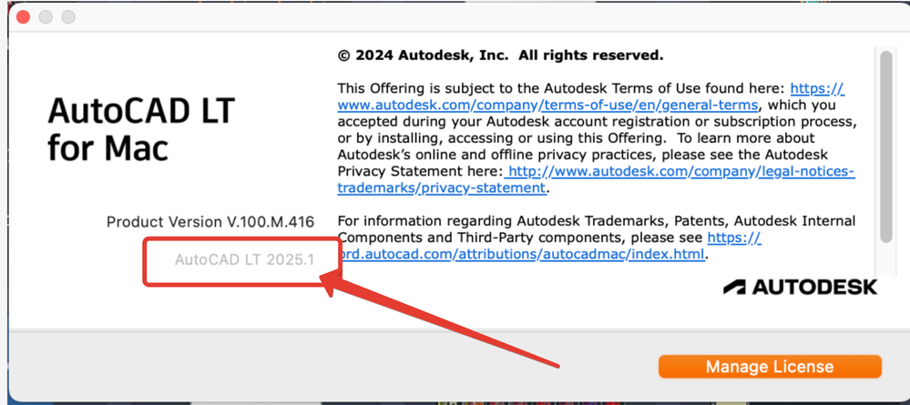

Message 6 of 12
iamshanice
My verion is 2025.1

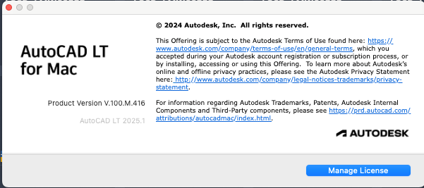

Message 7 of 12
iamshanice
My verion is 2025.1
