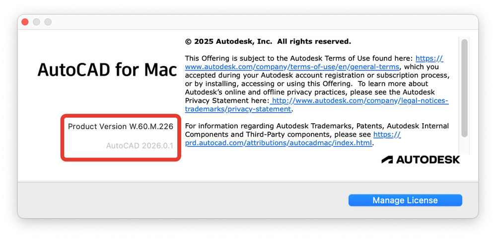

Hi @garett_rowe273 ,
In your screenshot I noticed that you still haven't installed the 2026.0.1 Update.
Not sure that it will help to correct the problem with Tahoe, but anyway...

>>>>Installed by itself unfortunately
For the future: turn off Automatic Updates in macOS System Settings:
Not sure what you mean by "manually installed", but if you installed it, you should see:
 but not this (from your screenshot):

garett_rowe273
Thank you, @maxim_k .
I installed the latest patch successfully this time, but the issue is still there.

maxim_k
@garett_rowe273 ,
This Update fixes issues with macOS Sequoia, but not with Tahoe.
I only mentioned it because I noticed that you don't have this update installed.
For now - let's wait for a new Update from Autodesk.
