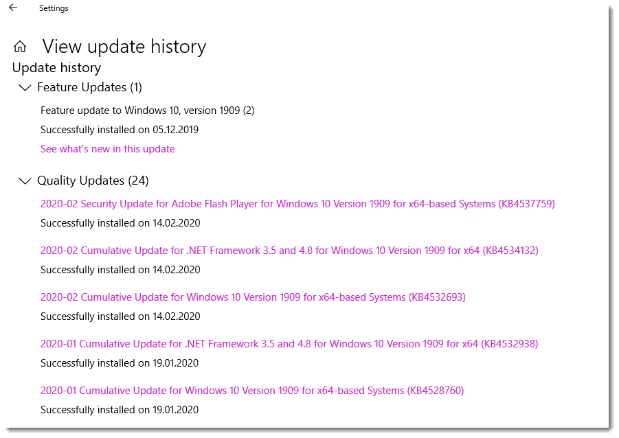

The following updates have occured on my machine today
KB4534132 - U
kb4532693 - U
KB4532938 - U
KB4528760
KB4515871
I could only uninstall the ones marked with a U
My Autoreporting worked fine until lunchtime. I rebooted the machine and the updates above came through.
Since then AutoReporting creates excel files with a date of 14th April 2020. The files remain locked for 1 minute by a user called "chongy" after autoreporting completes. After Autocad releases the files the dates update to todays date of 25 Feb 2020.
On opening the files, there is a blank row inserted at row 2 (see attached image)
The extended file lock and insertion of a line appears to be a problem caused by the microsoft updates.
Can Autodesk please look into this.

Message 11 of 20
kris.wu3AK4F
https://forums.autodesk.com/t5/autocad-electrical-forum/task-list-no-pending-updates-found/m-p/93170...
Microsoft access Database Engine update from Window update has screw up AutoCAD Electrical and there is no AutoCAD electrical update to fix this.  you need to manually down grade your database engine to office 2010.
https://www.microsoft.com/en-us/download/details.aspx?id=13255
this should fix the issue.
just run the repair and try.
Message 12 of 20
mark.electricaldesign
Hi kris.wu3AK4F
You beauty!!!! That has resolved my issue and on top of that has uncovered some subtle errors occurring in our drawings that we were not even aware of where panel components were not being updated after updating schematic components.
AutoDesk will need to be made aware of this so they can advise all their clients.
Top man!
Mark
