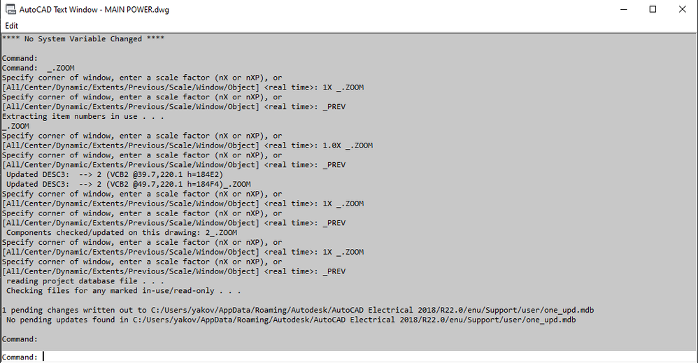

I AM USING AUTOCAD ELECTRICAL 2015
MY PROBLEM IS WHEN I AM UPDATING ANY PARENT COMPONENT (NO METER WHICH FIELD) AND SELECTING "OK" WHEN ASKING TO UPDATE THE RELATED FOOTPRINT WHICH IS IN ANOTHER DRAWING IN THE PROJECT,IT IS NOT UPDATES.
WHEN I LOOK IN THE COMMEND LINE THIS IS WHAT IT SAY
1 pending changes written out to C:/Users/yakov/AppData/Roaming/Autodesk/AutoCAD Electrical 2018/R22.0/enu/Support/user/one_upd.mdb
No pending updates found in C:/Users/yakov/AppData/Roaming/Autodesk/AutoCAD Electrical 2018/R22.0/enu/Support/user/one_upd.mdb
WHEN OPENING THIS FILE IN ACCESS, I CAN SEE THE CHANGE I MADE APPEAR THERE.
BUT IT IS STILL NOT WORK.
BUT! IF I AM SELECTING "TASK" AND THEN GOING TO THE TASK LIST AND PRESSING "OK" THE ACE IS UPDATES!!!
ANOTHER PROBLEM IS THAT THERE ARE SOME LINES IN THE TASK LIST THAT JUST STOKE THERE, NO METER IF I SELECT THEM ALL AND PRESS OK OR REMOVING THEM THEY STILL THERE.
CANT FIND ANY SOLUTION FOR THIS, I WONDER IF THERE ANY FILE BEHIND THAT CAUSE IT.

I also have this problem. ACE 2018 though. I can post as a new question but I'm guessing these are possibly related.
I have two computer doing the same thing and a third that does not have this problem.
See screenshots.
I change the tag of a parent symbol. It recognizes there is a child symbol elsewhere and asks if I want to update it. Ok. Then it does nothing. (See "No pending updates found"). If I open the task list there is a task stuck in there from hours ago with a similar tag change I tried that also didn't work. (See "The pending update") You can see that this is not the current change I am trying to make (See "The actual change"). I have another screenshot of the child symbol untouched by any of these changes but looks like I can only add 3 screenshots.
This happens in multiple project files the same way. Also won't let me move terminals from one terminal strip to another. Acts like it does the change but when I click "done" and exit nothing has happened.  Ignores the change unless I select the new terminal strip before clicking on done. Then it works. Seems to have started around the same time.

HAY TO ALL
I NOTICED ABOUT MICROSOFT OFFICE 365 UPDATE IN 12.2.2020
I CHACKED THE EXPORT TO SPREADSHEET-> PLC ADDRESS -> EXCEL.
WHEN TRYING OPEN THE FILE I GOT THE MASSAGE IN THE PICTURE
CAN YOU TRY TO DO THE SAME AND CHECK WHAT ARE THE RESULTS?
THANKS
Message 10 of 16
GOOD NEWS!!!!
AFTER LONG CALL WITH MICROSOFT, THAT I ASK TO DO DOWNGRADE TO MY OFFICE365
THE ACE GAVE ME MASSAGE "aceredist.msi IS MISSING" SO WHAT I DO WAS UNINSTALLING  "Microsoft Access Database Engine 2010 Redistributable"
DOWNLOADING FROM HER https://www.microsoft.com/en-us/download/details.aspx?id=13255
AND EVERYTHING WORK PROPERLY NOW
I ASKED MYSELF WHAT FIX THE PROBLEM - OFFICE REINSTALL OR ACCESS DB ENGINE?
TRIED ON 2 OTHER COMPUTERS THE "ACCESS DB ENGINE" REINSTALL AND ALL WORK NOW!!!
PLEASE TRY AND LET ME KNEW YOUR RESULTS

trabuck7
Thanks for the follow up. Instead of uninstalling and reinstalling the Access Database 2010 Redistributable, I ran a "repair" on it and so far this morning, I've had no problems. I'll update later today if I find it to start acting up again. I, for one, and pretty tired of these Windows 10/Office365 updates. It seems every time they push something out, it breaks something with AcadE and you either need to "repair" something or uninstall the update until a fix comes out.

benj.boyd
This worked for me also.
System Settings -> Add or Remove Programs
Searched for "access" to find "Microsoft Access database engine 2010 (English)"
Clicked on "Modify"
Selected "Reinstall or Repair Microsoft Access database engine 1010 (English) to its original state." -> Next, etc...
Now when I modify the attributes of a device all of the other associated symbols also get updated.
