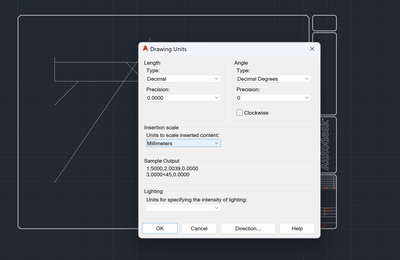

Hi
When attempting to insert a ladder I get the following
the template used is "ACAD_ELECTRICAL"
Units are mm

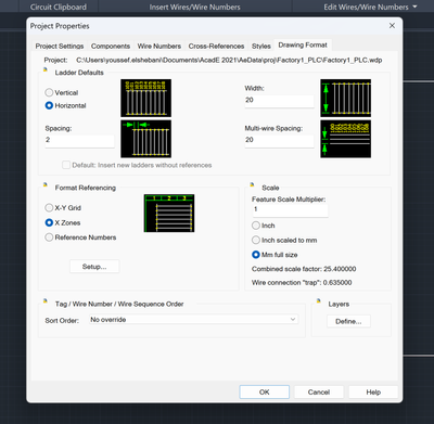

the project properties for drawing
I tried the following widths and spacing with no success
No                           Width                         Spacing
  1                              20                                   2
  2                              10                                   1
  3                              40                                  4

I get the error code
bad argument type : numberp : nill
lucy_wooding
Autocad electrical 2021
Windows 11 64 bit

Use a different template. ACAD_ELECTRICAL is drawing with imperial units. Try ACAD_ELECTRICAL_IEC instead.
