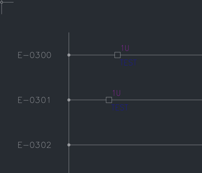

My apologies for hitting you up again so much later. My company primarily uses 3-tiered terminals and 8-tiered marshaling blocks. Here's an example of how a 3-tier terminal might be used with the strategy we are discussing:
 I understand that using any wire layer ending with "JUMPER" is ignored by TSE which is great (for example, the wires between terminals in the image above are all on a layer called "TERMINAL_JUMPER" and do not register on TSE).
In the images above, you can see the graphical and tabular terminal strip generations. On the left, the wire numbers are glitching out and the center says "3U1" even though that is only one of the six wire connection points. On the right, this massive table represents just two individual terminals. My question is, when you open the TSE and want to generate tabular or graphical terminal strip representations, do you have any tips to do this in a better way? Thanks so much.

Hello Niklas,
No worries, I am always happy to help. I think all you need to do is modify the footprint to show the wire number and terminals numbers correctly.
If you select the terminal footprint, you will see that the wire number and terminal attributes are already populated.
Wire numbers attributes are positioned to overlap with next terminal and only one terminal number attribute is visible.
You can modify the footprint dwg to reposition the attributes on what looks best for you. Set the attribute visibility based on what you want to display.
Eventually you will end up creating custom drawings based on catalog but I think for now you are just using the wd_default_multiterminal.dwg
Usually located under: C:\Users\Public\Documents\Autodesk\Acade 20xx\Libs\panel
Make sure to either use swap/update block (AESWAPBLOCK) or delete the terminal strip layout, purge the drawing, and then insert the strip again, just to make sure that all the changes you made to footprint block are being reflected properly.
Example below:
Attributes used: (this is just for position references, don't delete the other attributes like P_TAGSTRIP)
Example circuit used:
Hopefully this helps, Let me know if you have any further questions!
