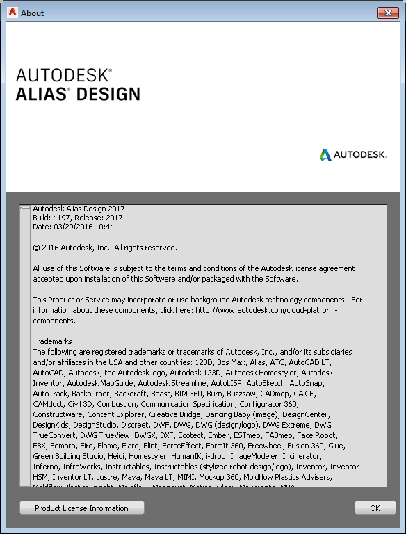

On a fresh new install of Alias Design 2017
By trying to activate or find the Freeform Blend tool, it does not occur in the Palette>Surfaces>...
As an option to activate it does occur in Preferences>Interface>Menu editor>Palette>Surfaces>Multisurface Blend>Freeform Blend. Though even by setting a shortcut key there the Tool is not present and can not be used or activated.
No way to create a Blend surface with the Freeform Blend Tool as it is missing completely, though it can be seen in the Hotkeys/Menu Editor but can not be used.

As there is a new release of the Alias Design 2017 mentioned earlier, I redownloaded Alias Design 2017 from my account and installed it.
Now the installation of the Hotfix did work out.
Although, it is important to mention that the Hotfix needs to be downloaded from the user account not the public knowledge base area!
If one does download from there, after applying the Hotfix the "Freeform Blend tool" would sitll be missing after the update.
