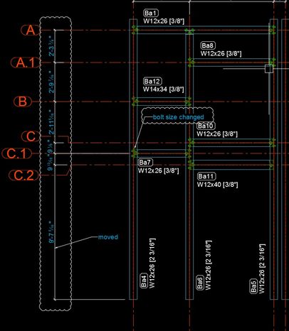

Hello Udo and Hello Dumitru,
Another secret is out - dimensions and labels moving again:
All default database for AS2018.
ZERO customization, using very powerful Autodesk certified video card / workstation.
The only thing that was changed was bolts diameter and distance to back of angles.
Dimension chain on the left moved with no reason.
I am also attaching the test model and folder.
Regards,
Ilko Dimitrov

It looks like the dimensions snapped at the break points at grids.
Please prevent this for future releases.

Hi Ilko
I was testing your model and i think i have the reason why your dimension are moving... you are using grids as snap points... in my test i was using only preferred for manual dimensions (steel beam axis) and all dimensions are kstaying in place.... :D.. greetings

What I am asking for is - prevent any snapping / movement etc. of dimensions once they are manually adjusted.
With the same set-up on the same day dimensions did not move 3 times out 5 updates.
But on a larger project-when they move-it gets ugly.
Once dimensions are manually adjusted-block any update.
We had enough fun already for so many years, enough is enough.
Ilko Dimitrov
