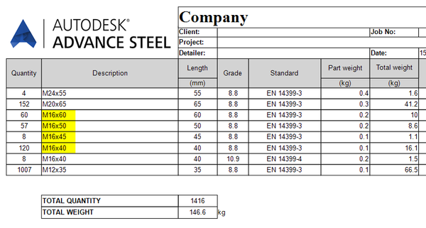

Hi Everyone,
From my model I got a long list of bolts with the same diameter but differnt length.
Can I define that the software will combine types?
For ex.: if I have M16x60,M16x50,M16x55,M16x45,
it will take the 45 and 50mm bolts and make them M50.
and the 55 and 60 it will union to 60mm.
so instead of having 4 types I will have 2 types.
thank you

in bolt properties there is an parameter that allows you to add length to the grip, this increases the overall bolt length.
if I recall correctly even if bolts are in a macro connection, you can access this field and add measurement.l, in this case add 5mm.
you could try using the search /query tool set to bolts and then under the bolt tab of search place the length you wish to find, in the length field.  That way you could edit many bolts at once.

Hi @johnjmbennett ,
I know I can add length to the bolts,
that is not my question, my question is if I can limit the bolts to specific length.
Or maybe check each bolt to see its length and and increase them to a specific length, if so, How can I select all the bolts in a specific length and change them all together.
Message 4 of 22
johnjmbennett
You use a search to find the bolts of the length you wish to change, as previously described, then use the select marked objects tool for the AS palette, to select them, then access the properties once selected via the contextural menu(right mouse button) , select AS properties, select the length increase field and type measurement.

The problem I have, can be seen here:
I have 4 types of bolts with a small difference of their lengh, I wanted to have 2 types only, so that the software will union the types and give me instead of 40mm and 45mm ,the longer one ( 45mm).
so they will not be confused on site,
and of course I need the software to check if the bolts can be longer and will not have a collision.
About the treads I don't care that it will be threaded all the way or according to the smaller bolt.
thank you

hi @eyal.ch ,
you are using HV-bolts (8.8), so be careful. Otherwise, I learned that in AS I have to check the clamping length (Klemmlänge), which defines the length of the screws, because depending on the type of structure (in my case transmission towers) it can often be carelessly different from the manually calculated one (even tenths of mm deviations in the transition area between the individual screw lengths are decisive). In the Project properties, only for the check purpose, turn on the length units to 2 decimal places and you'll see - then don't forget to switch it back, especially for creating drawings and BOM). Then all that remains is to add or subtract from the clamping length in the properties of each such screw. In any case, look at the screws in Management tools to see if they have the correct clamping lengths defined for the given screw lengths according to the appropriate standard.

To get longer screw, set some possitive value in the Grip length increase - you will see a direct effect on the length of the bolt in the same property panel and the change in its length also in model.

To see the quantity of the selected objects, look in the Property toolbar (CTRL + 1 to activate / deactivate even during active command).

This is correct if you inserted them as a group (not individual screws). All screws in the group have the same properties. You always have the option to split a group of screws into individual screws, if they are not in a macro. Then in the Property toolbar you will actually see the individual screws.
Otherwise, for an overall overview, the parts list is the right way for the final check. I apply the above personally for ongoing review so that I don't have any copied errors (transformed connections - copied, rotated, etc.).

eyal.ch
Hi @bigcarl5000kg ,
I don't want to break the group since it is a part of a connection.
After I filtered the bolts that I want ( e.g - M12x40) and I want to know how many bolts I selected,
and I want to changed all those selected bolts to M12x50, how to do it all in once,
because now I have to go one by one and change them manually and it takes for ever.
thank you

Hi @eyal.ch ,
if you filtered out M12x40, then by editing their properties add such an addition of clamp length to get M12x50. As already described, you can see the change directly in the properties.
Only the BOM will show you how many screws there are together, because some are in groups.

To count the filtered fasteners, create a BOM only from the selected objects.

I don't think it's been mentioned here. Apologies if i've missed it. But, you could also either modify the bolt database or create your own copy, containing only the bolt sizes you are looking for. That is, bolt lengths of 40, 50, 60... You could then set the increments to 10 and the bolts would automatically jump to the next size without the need for adding grip.
My approach would be to copy the database and create a new entry, rather than edit the existing one. This way, you can always go back to the standard should you have extra requirements (thread lengths, thread projection beyond nuts...)

bigcarl5000kg
Select your bolts, create a list for BOM ... and very important ... create new selection without any activated check boxes. Create BOM and you will see ...
