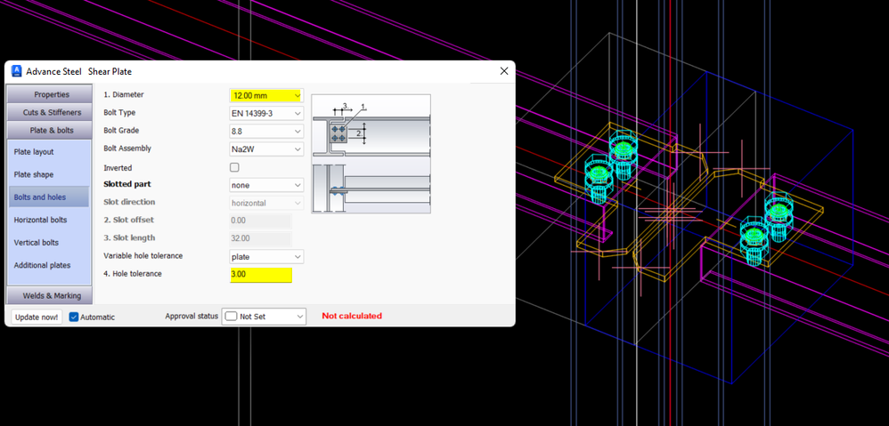

I have a problem changing the size of the holes so in the drawing it will appear correctly.
In the parameters of the connection, I changed the size of the bolts to 12 and the tolerance for the hole to 3mm
and it supposes to be 15mm in the hole.
when I clicked the bolts I get:
I can't change the size of the hole in the parameter of the bolts, it's in grey.
in the drawing I get this:
please help

In the makro, you have the variable hole tolerance set only for the plate.
Set it to plate & beam

I've had headaches with this macro in the past as well.  I can't recall now if I resolved by doing an Update all in the Macro or edited the holes separate to the macro.

I have a very big problem with this matter, can anyone suggest how can I edit the holes that are in grey?
the hole tolerance suppose to be 3mm, how can I change it?
when I click the hole feature I get this, 13mm instead of 15mm:

Hi @eyal.ch
You have set the hole tolerance for 3mm in the plate and the labelled drawing is the beam.
You will have to select both or the beam.
In your last image the hole in the plate is set bigger.
