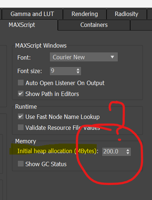

Biped? Layers, Mixer?
How much memory do you initially allocate?
Message 17 of 22
mx_zwh
default:100
