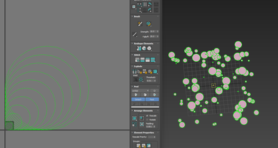

I have a mesh with the UVs shifted. Thousands of Islands that after being packed, are shifted (adding/subtracting whole units) into different UV quadrants. I need a script that moves all islands to the main UV Space as it was packed originally. Island by island move them by whole units until they are in the 0-1 range (subtract the whole part of its position so it is U: 0,xxx V: 0,xxx).

Could you provide a picture of the desired result?
Message 3 of 11
rartidiello
yes sure,
Message 4 of 11

Message 5 of 11
rartidiello
I'm sorry but I don't think this script is moving the UV islands by whole units until they are in the main 0-1 UV space.

I haven't make it work properly on my side😓. First the script is working for Editable Mesh and I needed it for Editable Poly(which I didn't specify) but even for Editable mesh it is not working as I need. For example in this sample Sphere.
it does this, and ignoring the peaks it is moving the islands to the origin (0.0.0) and not preserving their relative position on each quadrant.
this is the expected result.
