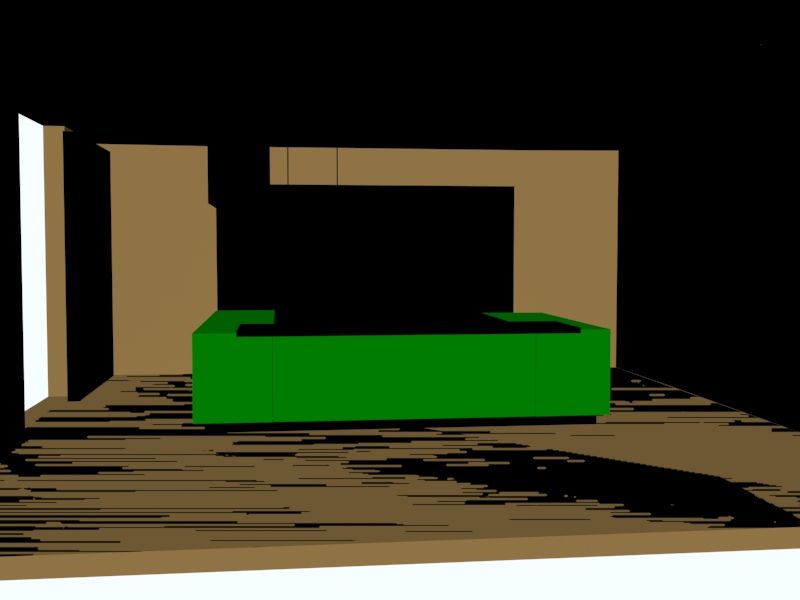

Hi Ali I did what you suggested and selected single frame is illustrated and the error message did not appear so that's good - however when I tried to render it returned just a blank white screen again which is a pity.
I wonder what it could be?

hi dear friend check your materials carefully i have checked there is some problem with them as you are using vray check its render settings.
thanks
