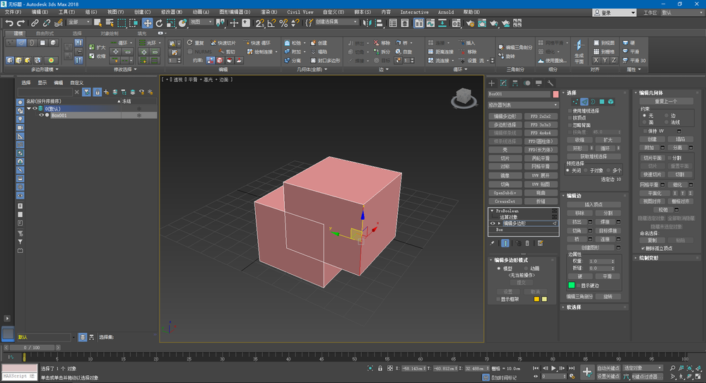

problem 3d max 2018,can't see the red line,proboolean

hdcboy
The red line is the color that should appear when selecting an edge

hdcboy
not this one. In  proboolean the editor,

tony.su
Autodesk Support
Autodesk Support
我觉得很有可能无法显示红色。
我猜测,其实是显示了红色。但在viewport里面显示的是boolean后的物体,压根就没有显示你选择的目标物体。
如下图,我选择的线压根就没有显示出来,因为显示的是最终物体。所以boolean后能改动原始物体仅仅是一个选项,最好不这样做。

hdcboy
Bad news, it's impossible
Message 12 of 18
hdcboy
Why is max 2012 normal

hdcboy
(proboolean must select operands) Correct steps:
try in 2016 Please
Here are the correct instructions
Message 17 of 18
hdcboy
Celebrate, solveSmiley LOLHeart
There's something wrong with the video card setup
 snipaste_20180713_192539.pngsnipaste_20180713_192623.png snipaste_20180713_195501.png
Message 18 of 18
hdcboy
, but it is flawed.
