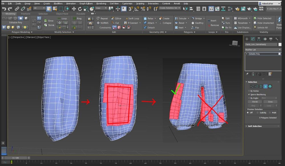

Please give us an option to turn off sub level selection. I would like to be able to select what we see (in shaded mode) not what is under or turned off. I am constantly rotating and panning my scene to get the selection i need.
The suggestion is applicable both in object level and subobject level, only select what is drawn on screen when the selection rectangle is dragged over the area, not what's hidden behind.
I would like this ability too please. This selection feature should apply to vertex, edges, and polys. Could put the check box there under 'Ignore Backfacing'. Could call it 'Visible Only'
Yes limit selection to visible is badly needed. Like the functionality in Blender or C4D. Max seems to only be able to turn off the selection when the normal faces the other direction.
@Chaytec there's initial implementation in 2022.1 (in addition to Ignore Backfacing, there's now also Ignore Occluded). As with other new features like smart extrude, it's being rolled out in steps so things like marquee selection are bound to come later on (next PU or point release).
