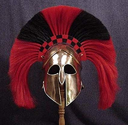

I still havent played with or used any hair/grooming system now. I dont intend to use the Hair and fur modifier for Creating character hair style and such.  I think I might need to use it for the hair crest (I think its horse hair) of some historical helmets like thesse Hellenistic ones.  Can I get very realistic results with the current hair and fur modifier ? It is easier to use than Maya Xgen ?
