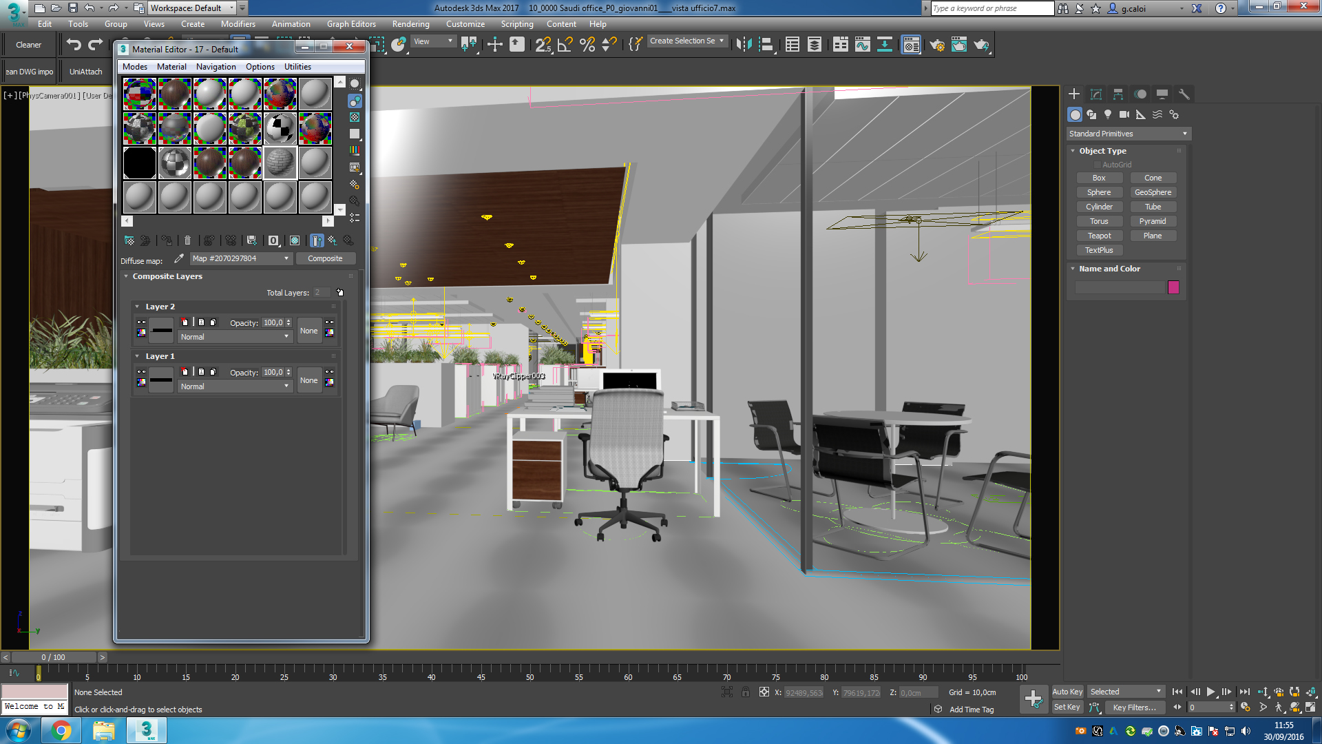

hi guys,
when i put a composite material in the material editor, i can't see anymore the thumbnail preview for each texture which is really annoying and i only see a black bar inside the thumbnail. till 3dsmax 2016 everything worked fine. How to fix this?
thank u guys

Message 2 of 31
RGhost77
I confirm, same bug (max 2017 sp3). Please submit as bug.

Message 3 of 31
Alfred.DeFlaminis
Hello @RGhost77 and @g.caloi,
Thanks for the heads up, I have submitted this to the bug tracker and can confirm it's happening to me too.  This was previously unreported.

Message 4 of 31
g.caloi
good morning. i've just installed the 2017.1 update...and THE COMPOSITE BUG STILL THERE! this is unacceptable
