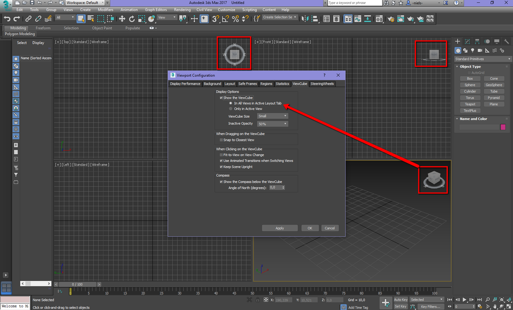

It's not the viewcube is it?
If it is, you can right-click on it, select "configure" and you'll get the menu shown in the image where you can change it's settings.
