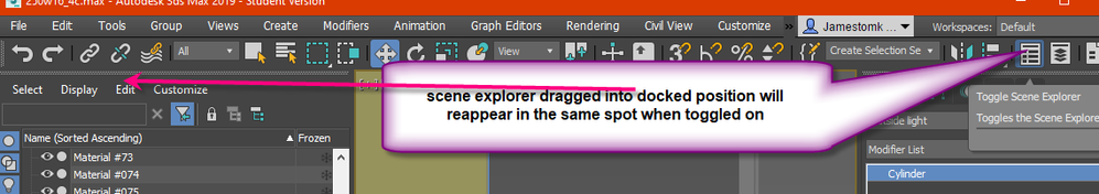

rather ridiculous for Max to "hide" this "open last explorer" under the "Open" alpha-sort list!
It's shortcut is Ctl+Alt+O.
If you've dragged/dropped previous Explorer into a docked position, it will re-open there when toggled by the toolbar button or it's assigned shortcut.

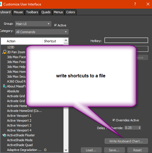

also, it us useful to export the list of shortcuts to a file, which can be done via the "Write keyboard chart..."  I attach a csv file I refer often

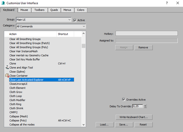

It's definitely what i was looking for! Thank to you i also found the way to hide this docked Explorer. By command "Close Last Activated Explorer". Which is useful when you need to do kind of processes that do not require looking through the sorting/layer list. Cool that there is a possibility to enlarge the working space.
I've already thought that it is not possible in MAX with using a Hotkey.
I never used that "Write Keyboard Chart". Only "Save" /"Load" buttons.
And I also have several questions:
1) How do you export Hotkeys to the CSV file? I have only the TXT type in list.
2) Why your Hotkeys are duplicating? There is an opportunity to use the same hotkeys fo different functions? Or this is just a bug?
To create the csv file, i saved the txt file from Max, started Excel, opened the txt file and it guided me through mapping the columns (I think there's a tab between the description column and the key-shortcut column in the .txt file).  there's another posting elsewhere in forums discussing this.
