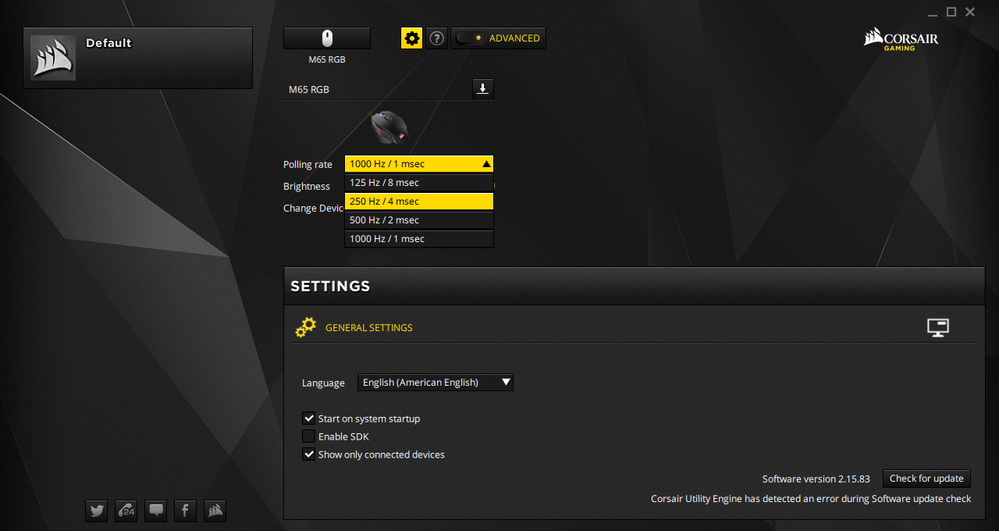

I've seen this problem dozens of times over the years but really didn't expect it to be an issue with the machine I'm on at the moment. Panning and zooming are super smooth but orbiting with either the mouse or orbit tool can freeze/lag for up to five seconds before updating the viewport. I've searched the forums high and low but none of the other suggestions has made any difference.
Spec: Ryzen 1800X/3.6GHz, ASRock Taichi, 32GB DDR4 3200, GTX 1080 w/ 384.94 driver
What I've tried/tested:

One odd thing I've noticed (a clue?!?) is that moving the mouse slowly seems fine but if I speed up it freezes. So I uninstalled my mouse driver bloatware (Corsair M65) but that didn't help, so I updated the chipset drivers in case it was USB related and that didn't do anything either, then I reinstalled the mouse software and lowered the polling rate as mentioned above, no joy.

I write a post alongside tearing out chunks of hair and trying random things for three hours and then almost as soon as I post it, I stumble upon the fix. Posting in the hope it'll save someone else the anguish/late night trip to the beer shop. Well okay, you can still have a beer...
Anyway suspicions were right, it was the mouse polling rate all along. Not sure why it didn't work the first time I tried it (I've reinstalled the driver since then) but I can reproduce the issue no problem at all now.
Here's my mouse driver:
Capture.PNGThe results I get are:
125Hz: No lag
250Hz: No lag, doesn't seem any different to 125Hz but it's so fast it's hard to tell
500Hz: Pretty laggy but usable, just seems like a relatively heavy scene
1GHz: Lag central, hair coming out in lumps, monitor smashed, neighbours phoning the cops about the wailing noises etc...
I tried it without the hub and directly into USB2 and 3 ports and it's identical to the above with all. Weird that this affects Max and none of the other apps I use, but I guess that's one for whoever's in charge of the Nitrous driver...

I had the same issue with my Logitech gaming mouse. It was set to 1000 hertz and i got tons of lag with nothing in the view port! i saw your post and changed the polling rate to 500 and dang it was fixed! Thank you so much.

WOW! WTH I was getting horrible lags with the selection tool even on an empty scene. Luckily bumped on this post and reduced my mouse's polling rate from 1000 to 500 and it fixed it. Thanks man.

This issue should be fixed in 3ds Max 2022.3
3ds Max 2022.3 Update Release Notes
UI: Fixed lagging orbit viewport refreshes with high polling gamming mouse. MAXX-64056
