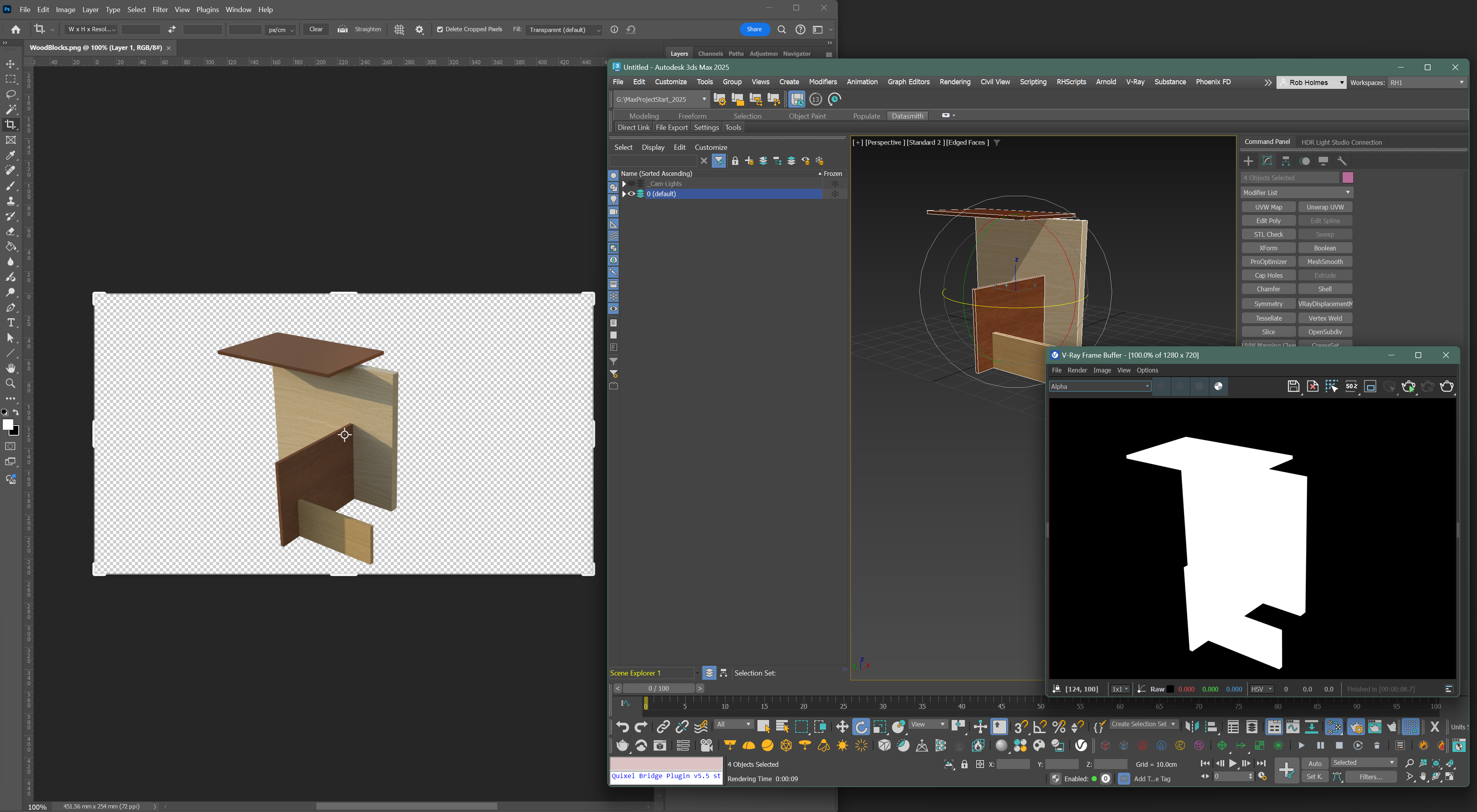

RobH2
I tested exporting PNG renders from the Max Common Settings and it worked perfectly. I attached a shot showing Photoshop, Max and the V-Ray render window with 'Alpha' selected. What Render Engine are you using and could you have accidentally turned off a setting that it causing the problem?

Dchimenti
OK!!!!!
It turns out it was the #%@%ing default OCIO setting. Switched it to GAMA and I'm now getting alpha with my PNG sequence.    Unbelievable that I lost all those basic hours banging my head against the wall because Autodesk decided to flip a new switch by default.
