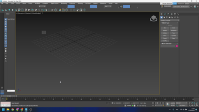

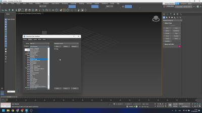

It seems that I violated the 3D max files and I received a warning that the files were damaged and the system gave me a choice, restore the system to the initial settings or leave it like that, I made a mistake and clicked option 2, how can I solve this problem now? (I tried re-downloading, but it didn’t help).2. When I put scripts into a file they don't work, did I do something wrong?

Then I will write everything down in detail. The first screenshot indicates that I have lost most of the icons, the other 2 screenshots show that the scripts do not appear in the customization panel. These are regular SoulBurn scripts, I've worked with them before and everything was fine.

The problem is not about copying anymore, but about how do I get these icons or ENU, or whatever this is back. When the system asked me if I wanted to reboot them, I had to do it.
siskinsergey623
I managed to fix the ENU, but the issue with the scripts is still open
RobH2
Soulburn scripts are dead and gone. RIP. Neil Blevins who developed and shared them for so many years said a couple of years ago that he was stopping and that for future versions of Max it would be unlikely that they would function. I'll try to find that  link.
Here it is....
http://www.neilblevins.com/art_assets/scripts/soulburnscripts_for_3dsmax.htm
