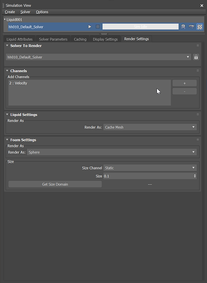

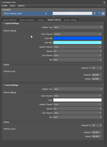

Here are the screengrabs. The machine I screenshot from is not where I usually work so there were no caches present hence why the viewport is empty and the sim is set to cache the mesh without having a foam and liquid cache made. Still, same settings giving me issues.2018liquidissues_03.png2018liquidissues_01.png2018liquidissues_02.png

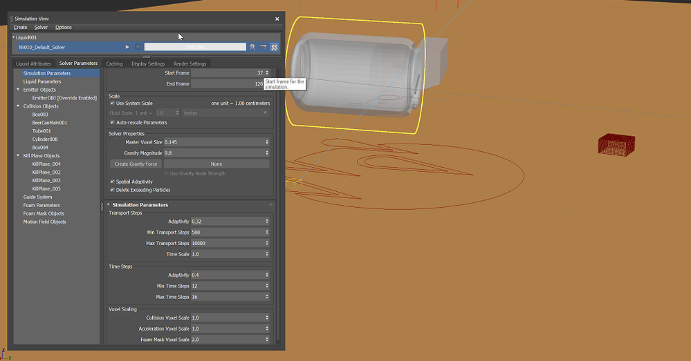

Thanks for your reply, and thanks alot for putting in the effort to make a video! Funnily enough I allready have this setup applied to my scene (me thinking I was so clever and all to figure it out on my own and trying it) but maybe the extra objects are not thick enough?
I have the original can still present as a collision object but I have a tube around the can that slightly interpenetrates the can's walls and a cylinder doing the same on the bottom of the can in addition as colliders for the liquid.
See attached screenshot for more details.
This in addition to me having 12-16 timesteps and 1000-10000 position steps
