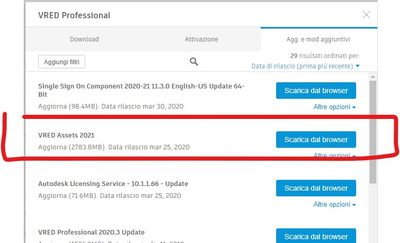

HI,
In the image i see that you are using the Automotive Assets.
For Vred you should have the Vred Assets 2021.
Best

Thanks for the replay. Its weird, I cannot find a link for the download... It only shows me the download link for vred

seiferp
Have you checked in Product Updates?
Message 8 of 8
I checked! Its working now! Thanks
