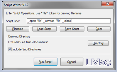

paullimapa
Use LeeMacs Script Writer
to run the -layer command to change the line weight on all dwgs in a folder

Message 6 of 8
paullimapa
After installation, follow the instructions shown on Script Writer page on what to input in the Script Line:
In your case it would be:
_.Open *file* _.-Layer _LW 0 GT_1  _.Qsave _.Close
Note: There are 2 spaces between the layer name GT_1 and _.Qsave to complete the Layer command between executing a save.
