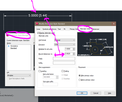

pendean
Community Legend
Community Legend
@skchui6159
Message 8 of 9
skchui6159
Thank you very much! I also want to ask that the text override can use the symbol of "<>" to show the real measurement in integer. Can I use MROUND function(use multiple by 5) like excel to input in the test override to show the Measurement by MROUND?
In excel:
Message 9 of 9
Kent1Cooper
@skchui6159 wrote:
... I also want to ask that the text override can use the symbol of "<>" to show the real measurement ....
I would encourage you to find the square brackets that are used for alternate measurements acceptable.  That way, if things get Stretched, both the more-rounded actual and less-rounded alternate measurements will update themselves automatically.  If you need to use a text-content override to get <> instead of [], then they will not update themselves, and you'll need to run a routine on the Dimension again [if you notice that it's needed -- an invitation for errors].
