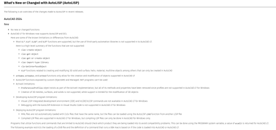

unfortunately it would not work in autocad lt, even in autocad 2024 lt, since it has no support for visual lisp vl* functionality.

Do you have LT 2024, cut and paste sections of code to test and what does not work which bit of the code ? It may be possible to do a work around.
I am guessing Hit-test.
If it is this then remove it. Hopefully no errors will occur.
vl-catch-all-apply

What I said was a possible work around may be needed, need to know which bit of code is failing VL* is just to broad a statement. There is support for a lot of VL in LT 2024, check out comments about what does not work.
Because LT 24 does not have VLIDE you need to copy and paste to command line the code in small sections and test.

well, i was wrong stating that autocad 2024 lt does not support visual lisp vl* functionality. it does with some limitations(. but every vanilla version of autocad lt prior to 2024 lt as far as i know does not support autolisp in any form. yours 2013 lt too.

As stated lisp has only been added to LT 2024 any earlier version and it will not work.
