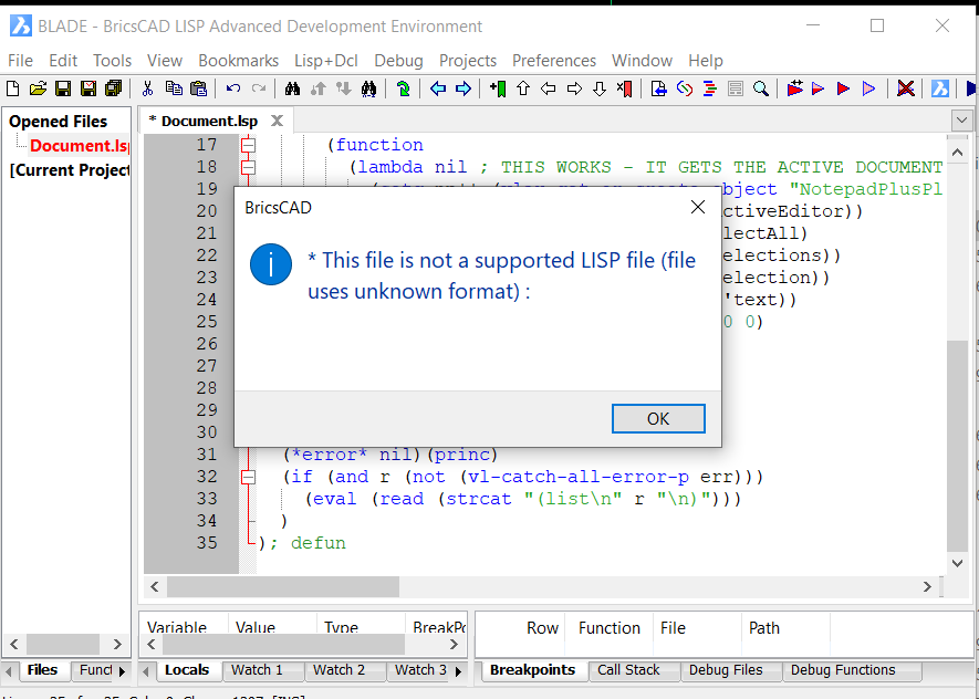

BLADE

Tried Blade copy and paste code never runs so skip it even though do most of my stuff in Bricscad.
