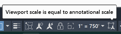

Hi! Running into an interesting situation when trying to scale the viewport of my layout with LISP.
Quick rundown: I'm trying to automate scaling the viewport to 1" = 750' by calling a custom command made with LISP. When doing this manually usingmouse and keyboard, I noticed in the command line that it uses the command _.MSPACE to enter the model space of the viewport, _CANNOSCALE to adjust the scale of the viewport to the predefined scales on the list, and then ._PSPACE to exit the viewport. Seems simple.

However, it does not increase or decrease the zoom of my viewport like it would if I am using the button at the bottom of the screen and clicking the corresponding value. If I type in _CANNOSCALE after calling the command, it has the value CANNOSCALE <1" = 750'">: , but if I type VPSCALE it will show the initial scale value. Therefore, when using _CANNOSCALE in LISP, it doesn't automatically match the viewport scale with the updated annotation scale.
There is a button to the right of the scale value for this, but from what I can (or can't) find, there is not a command to queue this. Does anyone know how it can be replicated in LISP, or if there is a different way to tackle this?

Based on your screenshots, it would appear to me that your Paper Space is setup to be INCHES and your Model Space to be FEET. If I am correct in those 2 assumptions, then this code below should work for you. I have set it up in a way so that when you input your desired scales, you can enter both your decimal/engineering scales (e.g. 1"=30') and your architectural scales (e.g. 1/8"=1').
