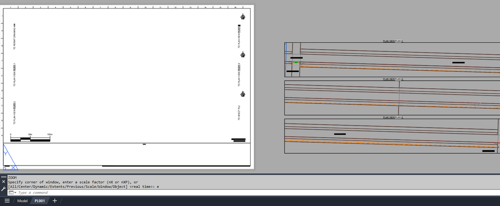

Here's a screenshot of the vports before:
After loading tst.lsp, I then enter at the command prompt tst and selected the top vport.
The AutoCAD message box would appear notifying "top vp placed" and after clicking ok here's the screenshot afterwards:
The vport moved as programmed.  Is this not what's happening for you?
Try my sample tst.lsp and see if at least this portion of the code works for you.
