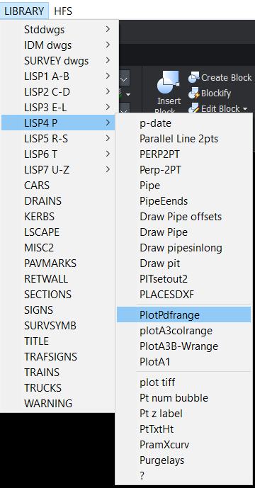

Sea-Haven
Just another way around the problem we had in our POP menu various plot options so you just choose the correct printer, and it used a custom lisp that just set the plot parameters. We had a multi storey office so the correct printer near to the user was auto selected. our A0 plotter was on a different floor as well.
If your using PUBLISH then yes need to set up the page parameters. That is another question but yes you can write a DSD file to be used by publish saves again user input.
