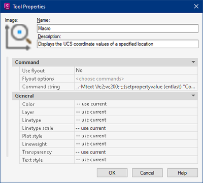

I'm trying to create a text, using a button with a macro in the toolpalette. The text-part works:
_.-Mtext \h;2;w;200;Mytext;;
Now I want to use tabs between the text:
Mytext -TAB- Mytext -TAB- Mytext
Using the tab-button in the Tool properties the cursor jumps to the next line. AutoCAD suggests ^I, but that creates 3 spaces instead of a tab. Using the columns-option is difficult, because the number of lines is not always the same. How do I get this working?

_.-Mtext \h;2;w;200;-;;(setpropertyvalue (entlast) "Contents" (strcat "MytextA" (chr 9) "MytextB" (chr 9) "MytextC"))(princ)
Message 14 of 14
gbG5A5W
Thnx, that works
