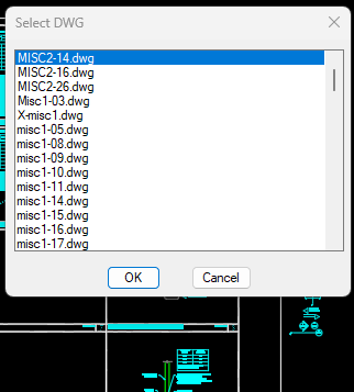

I've been using this LISP in the office for putting in the typical details. When it works you click on the category you want and the List Box lists all the details in the appropriate file locations. After the office switched to Autocad LT, now the listbox will randomly be out of order. In one attempt the foundation details will be out of order, and in another attempt the concrete details will be out of order. It seemed to start doing this out of the blue, and my LISP knowledge is woefully beginner. Any ideas on why the list is randomly out of order?

"...now the listbox will randomly be out of order. "
I assume you're seeing the drawing files not sorted properly.
The line of code that list the drawings in the directory is here:
(foreach dwg (LM:listbox "Select DWG" (vl-directory-files itm "*.dwg" 1) 1)
You can try adding a sort function like this:
(foreach dwg (LM:listbox "Select DWG" (vl-sort (vl-directory-files itm "*.dwg" 1) '<) 1)

In what way the list is out of order? As far as i can tell vl-directory-files function is always in alphabetical order.
Are you saying on some instances the same list  ( concrete details ) will be a different order when using the tool repeatedly?
Message 6 of 14
aaroncYPGMN
So this is the Concrete Footing option. My list of FDN details will be in order, but the next window for the MISC details will be out of order. It'll randomly happen, so say next time FDN will be out of order and the MISC will be in order, alphabetically speaking.
Message 7 of 14

That sort function seems to be working great. The only problem is it seems to grouping the uppercase file names and lower case file names in different spots (Misc1-03 is should be right above misc1-05). I'm looking at the vl-sort page right now but I wanted to see if you had any insights.
Message 9 of 14
paullimapa
well the only way is to force all dwg names to either lower case or upper case:
lower case:
(foreach dwg (LM:listbox "Select DWG" (mapcar '(lambda (x) (strcase x t)) (vl-directory-files itm "*.dwg" 1)) 1)
upper case:
(foreach dwg (LM:listbox "Select DWG" (mapcar 'strcase (vl-directory-files itm "*.dwg" 1)) 1)

It is working like a dream. Thank you so much!
